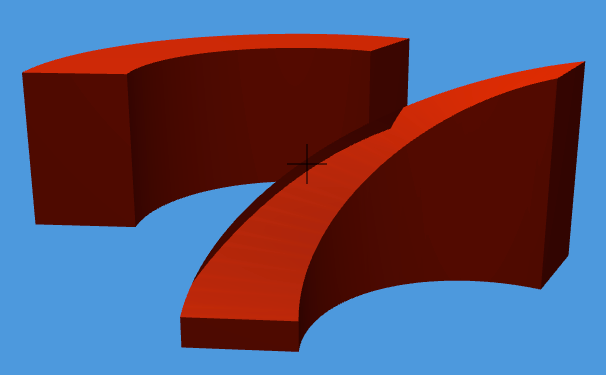

And without knowing if you will be using Archicad 16's morph tool or not, the tool enables changing the height of individual nodes. The main use for this, considering the existing ramp tools, is for banking the ramp and coping with site irregularities.
