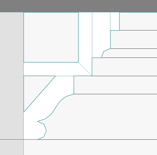

Here are some examples.
The first one was made in the Profile Manager - the rounded part is as smooth as possible by stretching an edge of the fill with the Curve Edge pop-up.
The resulting Profile is unusable if you ask me. Not nearly smooth enough.
That's exactly my problem!
Is there any way to solve or workaround that?
