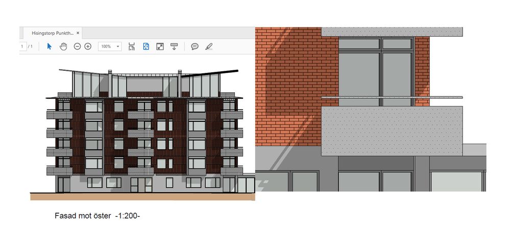

Red brick facade appears black in scale 1:200
I want my model to display a red brick facade. when i print the drawing in the scale of 1:200, the black lines between the bricks (in the texture) overlaps the red fill and appears dark brown/black. Any idea how i can solve this? change the scale of the brick texture or change the color of the lines in the texture or the line thickness? and how do I do that?

Check in the 'Surface Settings' of your material you're using which 'Vectorial Hatching' you're using for your material.
There you can choose another hatching with more distance of the lines for 1:200.
You can also change the settings of the fill type the material is using.
Or disable the hatching in the 'Elevation Settings'.

Where do I find the "surfice setting"? in the "wall selection setting"?
Dontknow
Surface settings: Options -> Element Attributes -> Surfaces....

Solved it. Thank you Dontknow!
