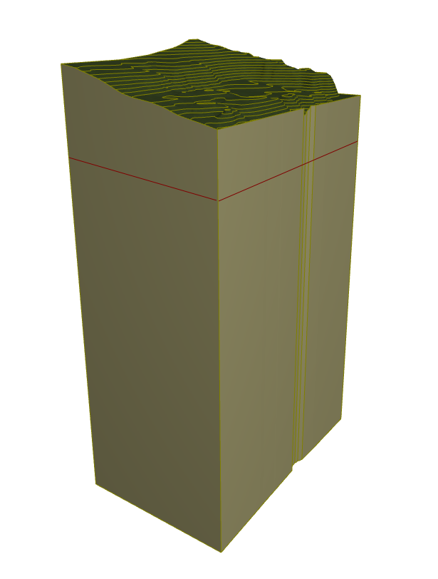

Reducing Mesh point heights by the same amount
Let's say I have a terrain modeled with mesh with different elevation for different isohypses. Is there a way to reduce the height of the whole model by certain amount without losing the geometry of modeled terrain.
I attached the picture, I want to remove the volume below the red lines.
Thank you in advance
5 REPLIES 5
David Shorter
I'm not sure exactly what you want to do here
do you just want to crop from the base up to the red line?
do you want to lower the whole mesh including the spot height?
I mean is it a cosmetic change or a real change.

Thank you for responses, but maybe I didn't explain it properly first time.
Mesh Height adds the height BELOW the reference line. If it has 0 value, the height of the whole mesh is determined by the elevation of the mesh point(s).
I made this Mesh from the isohypses from the topography. For example if I give one line of points an elevation of 15 and the other 20, I will have the shape above the reference line even if Mesh Height is set to 0.
All I want to do is to reduce this elevations by, for example, 5 meters. So 15 becomes 10 and 20 becomes 15.

Stress Co_
Select the mesh:
EDIT> Move> Elevate> Input: -5 meters

David:
In addition to Marc's advice, you could select the Mesh in a Section/Elevation window and drag it down 5 meters.
