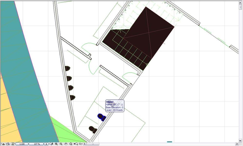

when i go to add objects such as toilets , lift, stairs etc. my icons appear with a black fill background.
i have tried to change this in the fill options but it wont change - which is strange.
i have added a pic so that you can all see what im talking about.
if anyone could help that would be great - thanks.
3 Replies 3
would just like to add that i would like the background white like normal

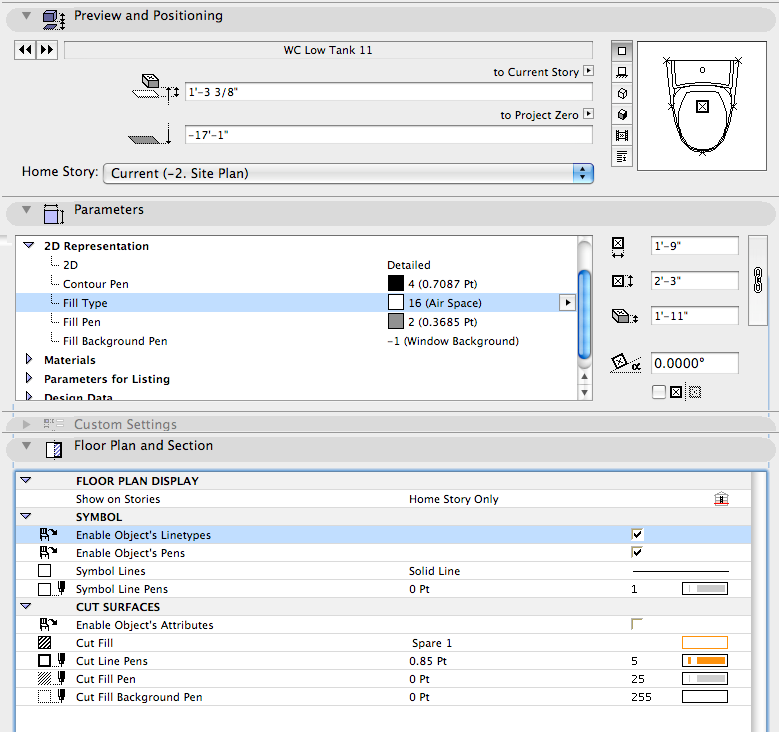

hmm... check your model view options and the object 2D apprearance settings and your pen set...
Stress Co_
Check your fill type in: Parameters> "2D Representation"...Air Space works for me.
Is "Enable Object's Pens" checked? : Floor Plan and Section> Symbol
