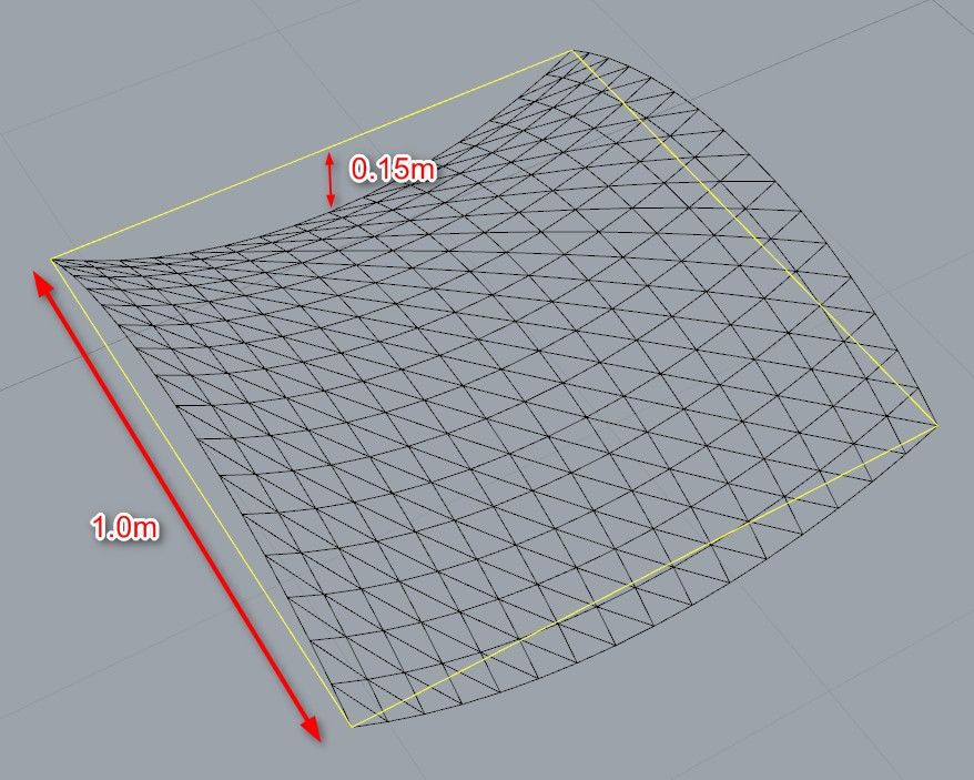

I just start playing with Morph tool and was curious what is the different btw. Rhino and Archicad "Network surface" tool. So, where four (4) curve define one surface. The surface that I made is based on 1.0m x 1.0 m rectangle and each curve has 0.15m height.
Polygons in archicad surface are not so organized. Any idea?

Can anybody answer whether it is a bug or just feature limitation.
It is a feature limitation. Or to say it another way: that is just not how it is designed and programmed to work.
The curved surfaces of a Morph element are not accessible for editing by having the for sides edge of the ruled surface available, for example.
