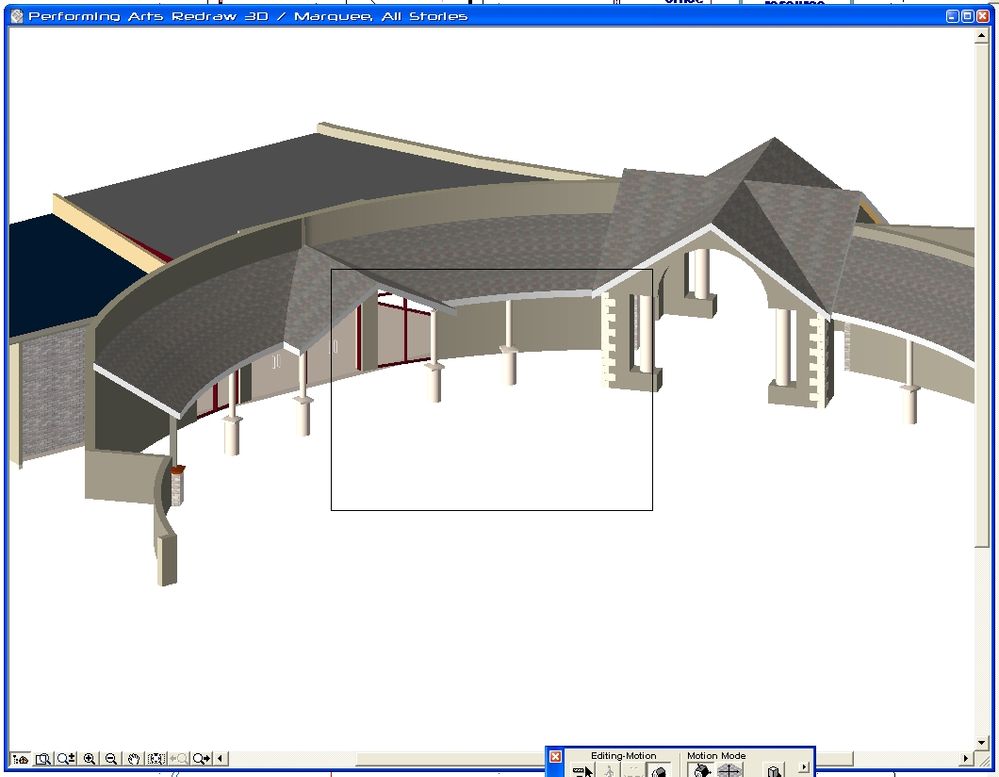

Yes please. Been trying to build a curved walkway with a sloping roof butting up to a curved wall. Ended up just doing it with lots of small controllable roof facets. Not perfect but good enough for now.
The Mesh to Roof add-on wasn't suited to the task? Still nowhere near as good as true curves though!

Hadn't thought of that. But this is my result - about 12 facets between each pair of columns, and reasonably easy to edit at junctions with other roofs......

Why didn't you use the mesh tool to make this kind of roof ?
(see attachment)
Also, how did you hide the edges of each of the 12 rooflets ?
If you don't mind me asking.

Oh I see the shape you were trying to create now. Yes, Mesh to Roof is probably not the best solution there - too many planes.
A simple mesh would have done the job, like Peter said, although I doubt it would have given you very good material texture control.

I hadn't thought to use the mesh tool as I have found it difficult to manipulate in the past (although I am getting more familiar with it), and hadn't realised I could curve the edges to get the shape I wanted. Now I know, I'll give it a go!
Thanks for the heads-up.
EDIT: Ah, but as Link points out, texture control will be an issue (asphaltic shingles, really need to have them follow the roof plane).
(And I had simply shown contours "off" in the OpenGL 3D window)
