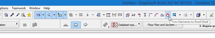

Here is where you can find 'Trim Elements to Roof/Shell'.

Dontknow, thanks, it works like a charm
This command is also available via the context menu: Connect > Trim Elements to Roof/Shell.

Dontknow
David
True. All buttons can be find in the menus.
