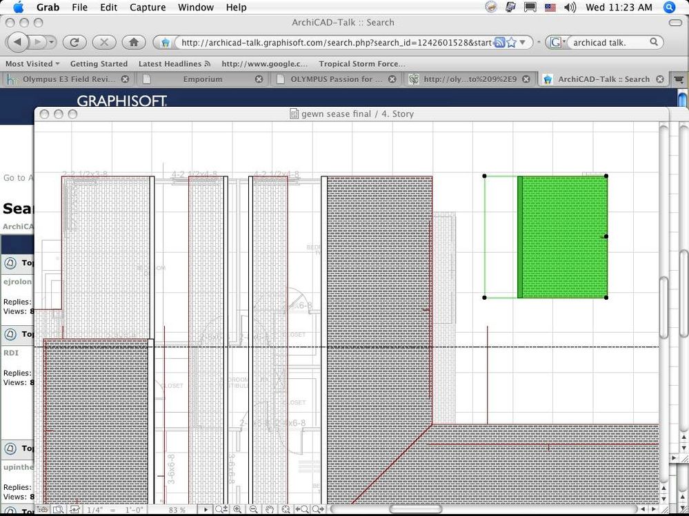

Help! Working in V12 for the first time, I imported this drawing from V10, and when I did, the roof elements are all trimmed in the Floor Plan window. I tried adjusting the Story Settings (yes, I can make this worse by decreasing the height to next story, but cannot make it go away by INCREASING--there is no next story), by adjusting the Projection settings, everything. It is as if there is a slab, or ceiling ABOVE the roof that is trimming it in plan view.
Any ideas?

Have you tried changing the "Floor Plan Display" (to "Outlines Only" or "Overhead All")?

That fixed it!!! I can't tell you how I struggled with this. Thanks for your help!

Guys--
my bad. I didn't mean TEXTURE, I meant hatch. I have attached a screen shot.
Was working in a program, doing some graphic art stuff, and it refers to hatches as textures. Sorry!
The screen shot is preliminary--just trying to get something out to start the pricing exercise. See--the hatch (shingles) is/are not showing up on the roof. All other views it is fine--plan, 3D, etc..
