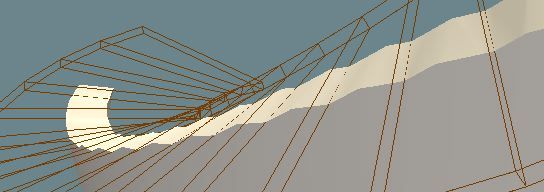

But isn't the curved ramp based on a circle? My stair is oval...
Dwight
CLose enough, but not a smooth trimmer.
Dwight Atkinson
Dwight
closer view
