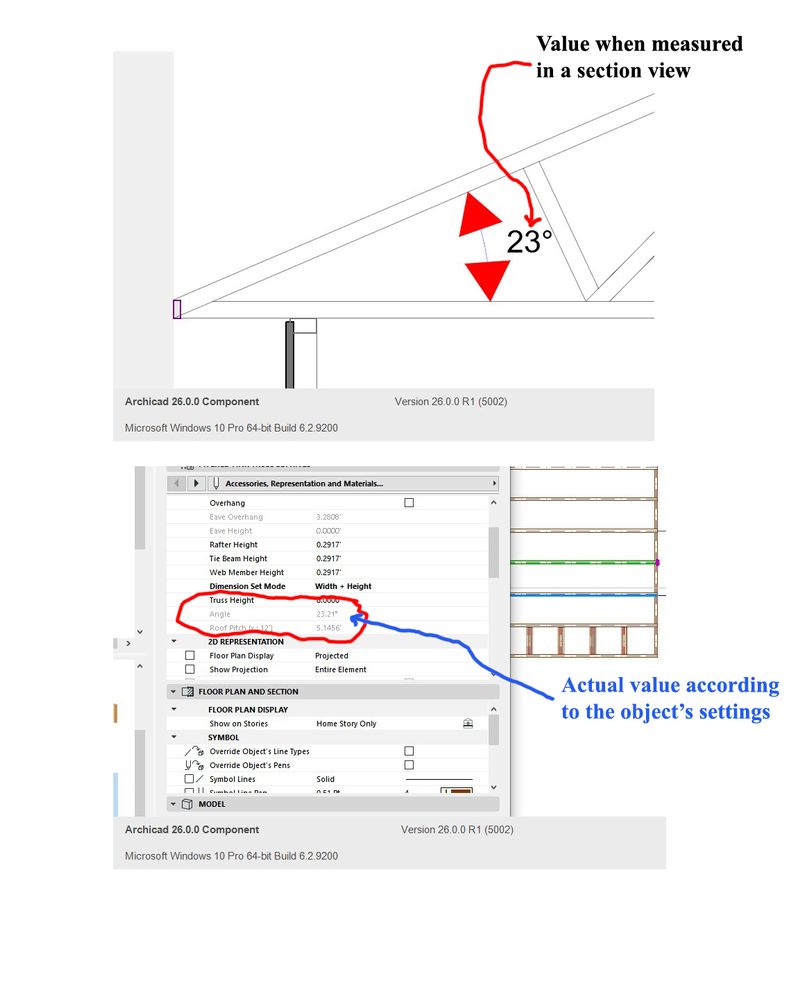

Please accept my apologies if this is in the wrong forum as I was not sure where it should be. In the design of my building I had a need for a truss so I selected the "object" icon and selected the appropriate truss from the library. I placed the truss where needed. When it come time to cost out the truss I was asked to send a drawing of the truss with dimensions. Since I had never had to this before I didn't know how to create the drawing in AC but I could easily create it in my MCAD software. To that end I started to recreate the truss which is where I began to run into problems. If you look at the picture showing the 3D and floor plan views you will see that they don't align with each other leading me to wonder what the rectangular boxes shown in the floor plan actually represent. I made many dimensional checks on both views in AC and nothing lines up. It should also be noted that when in the 3D mode the truss is created as a single item which means that the only snap points are on the extremes of the item. There aren't any snaps where the web pieces meet the chords making measurements difficult in the 3D view. It's not possible to get dimensions from the floor plan view as nothing lines up with the 3D view. I am hoping that someone might be able to explain why the floor plan view and the 3D views don't correlate with each other and what do the square boxes in the floor plan view represent. Also, is there a way to add snap point at the ends of the web pieces?
Thanks in advance.

The "boxes" are appearing as a consequence of your Floor Plan Cutplane Settings that you have under your plan view settings. They show sectioned timber at the set cut height.
To convey the dimensions of a truss, would you not be better dimensioning a section view?

DG: Based on your suggestion I created a section view for the truss and started dimensioning it with the dimension tools only to find a new issue - accuracy.
In the picture you will see the measured angle of the roof using the section view (top) and the actual design value from the object settings (bottom). I checked the dimension text presentation and it is set for 2 decimal places. I am not sure I can trust the dimension values shown. Any thoughts?

You need to look at configuring your dimension settings in Project Preferences, create your own style if necessary. AC will display as accurately as any construction fabricator can manufacture, unless you are designing precision engineered components, in which case AC may not be the best solution!
I gotta ask, are you related to the musical singer/song writer Carley Rae Jepson? As for trusses, I was trying to model the one I used from the AC library with my MCAD software that allows me to create a .3ds file which I can then use in AC and allows some modifications. As for the angle vs pitch of the truss, in my case I just provided the truss height and length and AC automatically calculated the angle. Anyways, I think I will stick to creating the truss in my solid modeler and then turn it into a .3ds file and import it into AC.
