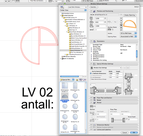

Is it possible to rotate the halfround window from the library so it is vertical instead of horizontal.? If not, how will you make this window easiest.
See attached image.

I would make this window with slabs. Draw the profile in 2D and then magic wand it with the slab tool active, cut a hole for the opening, then use another slab for the pane of glass. You will also need to make a hole cutting feature so the window will cut it's shape out of the wall.
See the whole process outlined in Building Objects Creation interactive training guide at Graphisoft.com
http://www.graphisoft.com/education/training_guides/#GDL

Thanks. That is also a way to go.
I found another solution on the web. Similar to yours but saving as a window object.
Nice to have several options for a problem.
