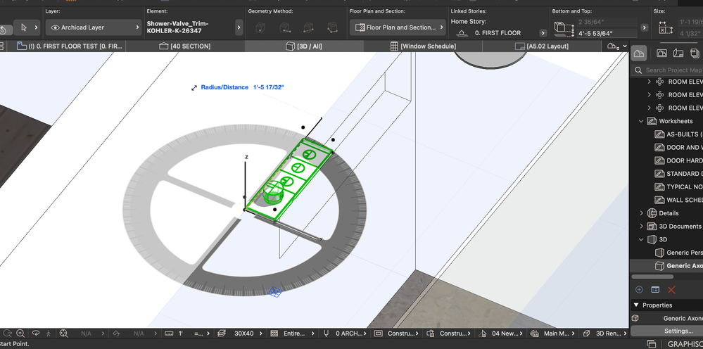

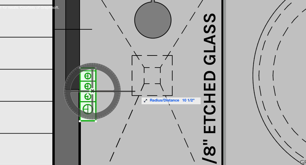

Hi, I'm trying to rotate this shower wall object I downloaded from the Kohler website as an RFA file, (Archicad 28)
How do I rotate on it's Z axis so I can place this shower component on the wall? I'm always locked into the x,y, axis.
I've tried changing the editing plane, going to a section and trying to rotate, I come from a revit, sketchup background and this is a very simple task so I'm at a bit of a loss!

vlahtinen
Try to convert the object first to a morph and then rotate. You might need to change the editing plane to vertical. After the rotation you can save the morph again as an object, if you wish.

thanks!
