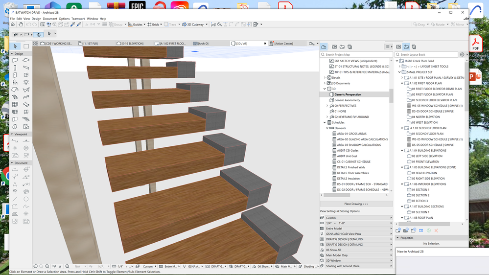

Greetings. Thank you for responding to my previous posts. This one is perplexing because it's never happened before. There seems to be an extension to my stair that is unacceptable. Please look this over and help me to correct the anomaly. I'm using version 28. Thank you in advance.
2025-09-25 04:48 AM - edited 2025-09-25 04:52 AM

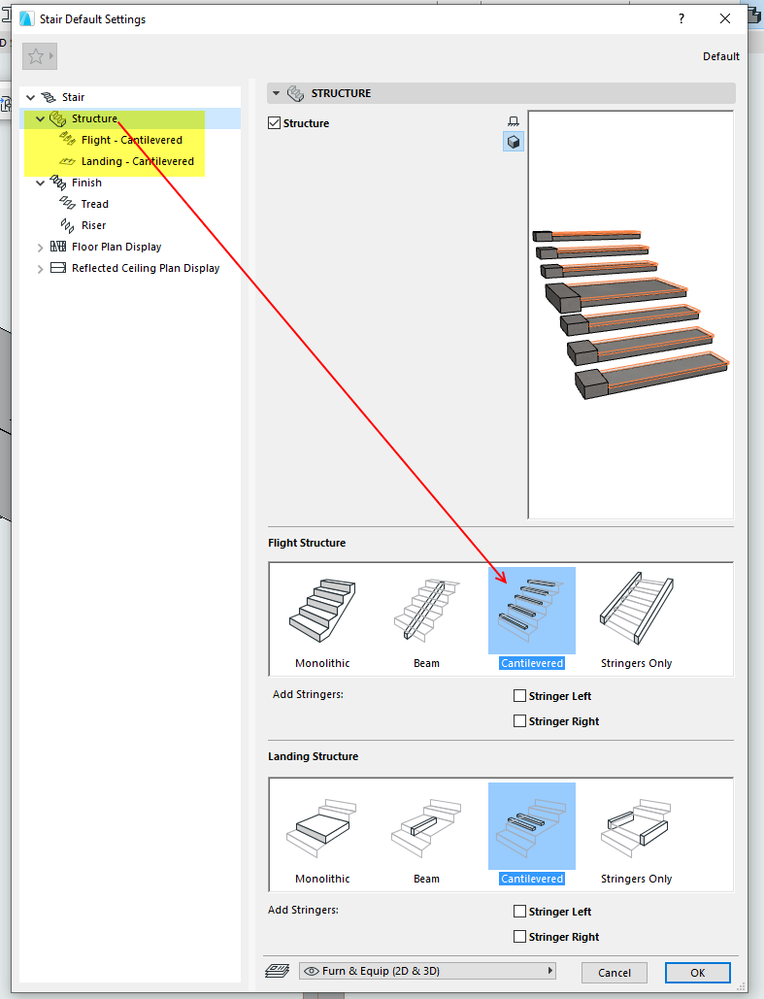

Do you mean the grey blocks at the ends of the treads?
If so it looks like you have used cantilevered treads.
These are the supports that will be embedded in the wall.
