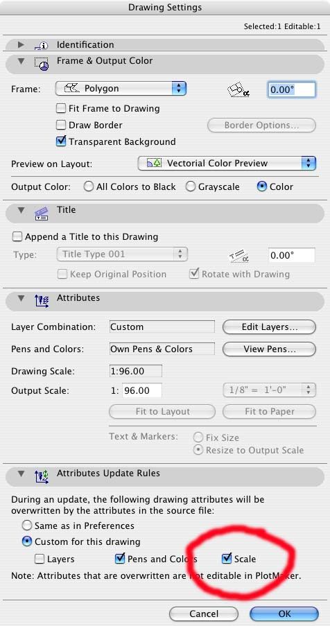

Leave you sheet set up as it is (like if you will finally plot to a Architectural D size). On a windows machine, first do a Page Setup... ;choose File/Print notice the Print Options... button; click on it. In the Print Options dialogue click Shrink Each Layout to Page.
Woody
probably should have also mentioned that in PlotMaker 3.1 you could also select the drawing; then go to Edit/Drawing Settings... ; then click on the Fit to Layout button
woodster
Also, when you open the drawing settings, you may find as I did the Fit to Layout button is greyed out and you can't access it. The next settings down is Attributes Update Rules. In this menu, un-check "Scale" and you will find you can now access the Fit To Layout button and it will then scale to your layout.
