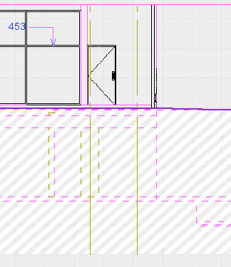

Does anyone have any ideas/suggestions for simulating screening in elevation view? Partially hide what's behind?

Just use a 25% fill with no border and a white pen for the dots (for starters). This fill alone may serve your needs if you also create several additional white pens that are fatter and fatter and combining the fill and pen to get the level of screening you want.
I use screen-fills like this to partially obscure foundation elements in elevation.

I use a similar system to Karl, with a borderless fill of 45 degree white stripes to partly block the foundations of elevations which are generated straight off the model, makes all the lines look dashed.
Tip: Make the fill by pasting stripes made of 'Solid Fill' into a new symbol fill, then you do not have to worry about the pen weight of individual lines, the stripe width being part of the fill.

Great tip, Bill. Picture says 1000 words.
My first reaction was "but the fill will completely hide some of the foundation linework that shows stepped foundation footings or struts" ... and the answer is (duh), to have a 135 degree version also. I'll still use the uniform screens in other places to fade elements at different opacities, but I'm going to switch to your technique for foundations.
