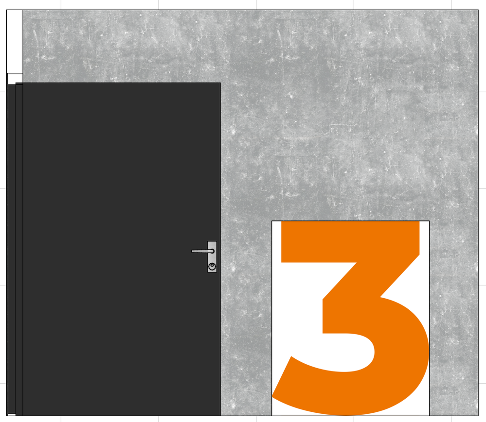

I'm trying to have a transparent fill in a section, but it turns up white. See attachment. Is there any way I can get the concrete of the wall behind the number to show through?
The number is constructed of a thin wall with the material on it; a transparent png with transparency checked in alfa channels.

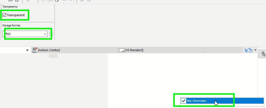

Be sure that you import PNG with alpha channel. Also check if these Picture settings are set correctly and check if Graphic override not interfering - try to use "No override" function.

Thanks, yes, this was probably a poor example. If it was just this number I would, but I also have quite a few other complicated designs.

Yes it is PNG with alpha channel. Turns out perfect in 3D, just not sections.

Transparency and PNG appears in Figure Selection Settings. Just select picture and go to it's settings.

Thanks, to use figure is definitely a work around. But I also visualize this in 3D, so I had made the design as a material with transparency, and put it on a wall. And that's when the transparency turns up white. I was hoping to not do double work..

If you wish to make both 2D and 3D correct representation. I would make custom profile of "3" number shape and have it as 3D. Not hard to make such shape as custom profile by redrawing.

Do you have transparency turned on for the section view?
