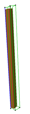

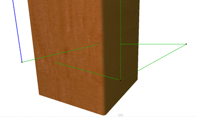

My Archicad 27 file just started behaving weird. The highlighted outline that appears when you select something doesn't match the geometry anymore. I have tried to restart my computer, update Archicad, update the graphics card and restart again. Nothing helps so far. Any suggestions? I add some pictures of an ordinary column:

https://community.graphisoft.com/t5/Project-data-BIM/Far-From-Origin-Troubleshooting-Guide/ta-p/3042...
Karl Wir_n
Thank's Lingwiser. It was an xref DWG that caused the trouble.
Lingwisyer
Guru
Yeah... I often get DWG files which are geo located, some being thousands of kilometers away from the origin...
