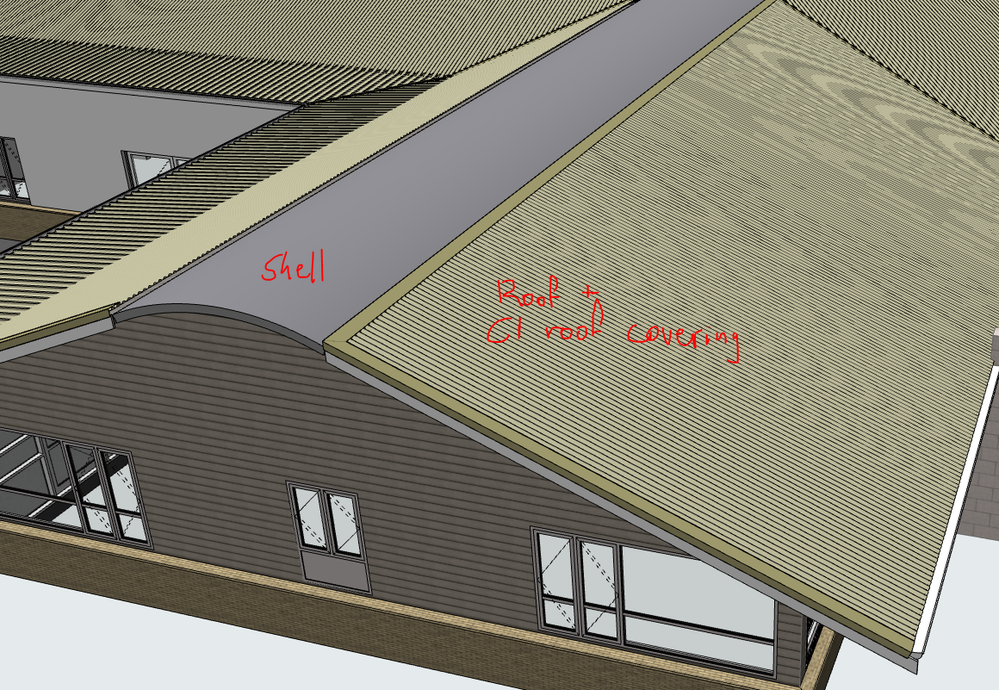

Hi, I'm currently trying to work out how my curved roof (done with Shell tool) can also incorporate the CI Roof covering to match the rest of the roof.
It seems that with the roof tool is impossible to make the curve I need.
Thanks in advance

That middle roof section would need to be a roof for CI tools to recognise it to apply roof sheeting over it as you would probably know ? I am not sure if the CI roof coverings will follow the curved roof section either yet ?
The shell tool will definitely give us a smother curve and I am not sure if you can convert a shell to a roof plane ?

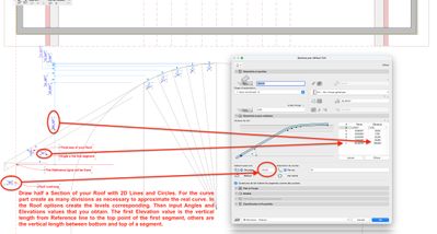

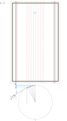

Hi, it's possible to create this shape with the Roof Tool except that you won't be able to create real curves, you will have to approximate them (see example) and it requires more work. 
