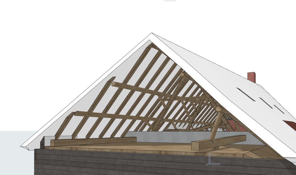

Thanks for your input. I tried making it into separate roofplanes, the problem is that the building roof is too crooked to get a planar shaped roof.
But I found a workaround:
I duplicated the roof shell and offsetted it inward with the roof thickness. So you have an extra shell inside the roof shell, I made this shell only wood material and constructed morphs which would cut out the parts I don't need (with Solid Element Operations), I put the morphs in a hidden layer. What is left is a construction which acts as a shell, so if I change my roof shape slightly, I need to change the ''construction'' shell simultaneously. But in that way the wooden construction always follow the roof shape .
I've added the result. Thanks again for your input!

mthd
Cool ! It sounds like you didn’t need to use the roof wizard after all ? That sounds like a complicated work around and I don’t think I would have the patience to do what you did, to get that fine result above. Resourcefulness and resilience paid dividends for you with that twisted roof frame.
