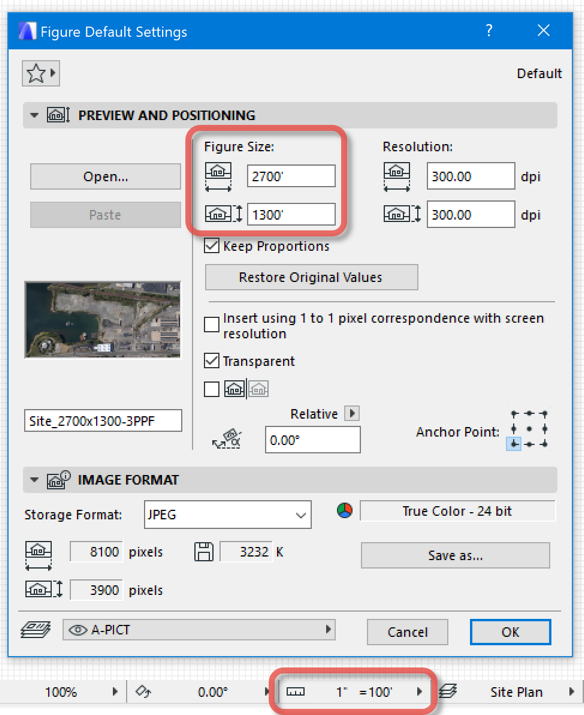

Step 2: Add an Aerial Photo to the Project
  • Get an aerial image of the site. Google Earth is often a good source of aerial imagery. There needs to be two points in the image of a known distance apart, in the real world. - The further apart, the better.
  • Drag and Drop the image into the plan window, which will place it as a "Figure". (Use a layer you can hide later.)
  • Use the Resize command to resize the whole image so that the two known points are the correct distance apart.
  • Then check the dimensions of the resulting image in the Figure Tool Settings. Record this size because later, it will be used for setting up the Image Fill and the Site Surface.
  • Alternatively, if you have an aerial photo with a known resolution, such as three pixels per foot, you can place the image using the Figure tool, specifying the dimension of the image in the tool.
  • In this case, it can help set the plan window scale to 1' = 100'.

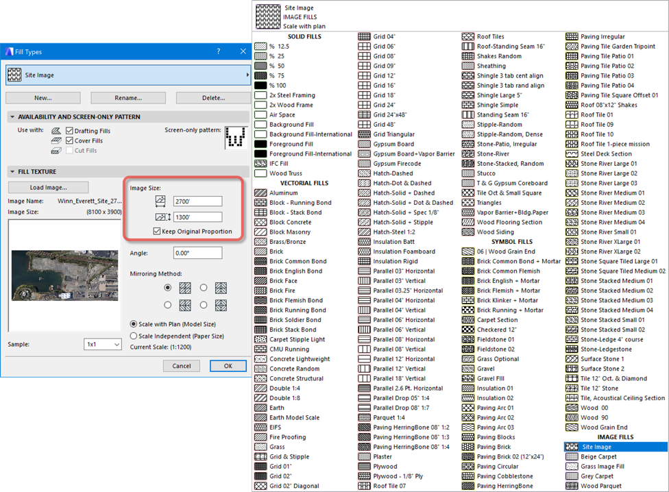

Step 4: Create an Image Fill for use as a Cover Fill
  • Add a copy of the image to the Project Library. If you do not have a linked Project Library, you can load the image into the Embedded Library.
  • Make a new "Image Fill" called " Site Image" in the Fills dialog, that uses the aerial photo set to its real word size (same dimensions as the mesh.)
  (In this example, the image has a real-world resolution of three pixels per foot, or 4" per pixel.)

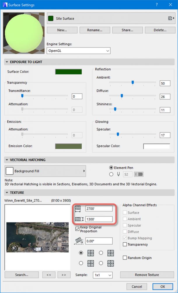

Step 5: Create a New Surface for the Top of the Mesh
  • Make a new surface called " Site Surface". (This could start as a duplicate of grass surface.)
  • Select the aerial photo from the library, as the texture and set its dimensions for width and height to the dimensions of the mesh.

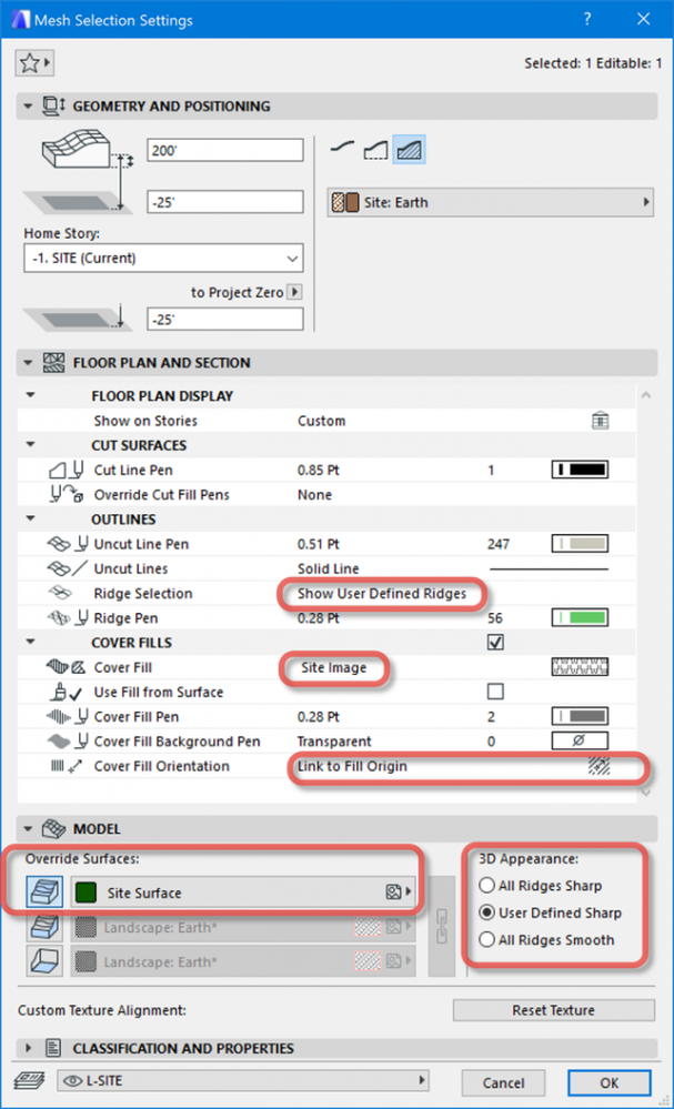

Step 6: Adjust Mesh Settings
  • Select the mesh in the plan window and set:
    • Top Surface override to " Site Surface"
    • Cover Fill to " Site Image"

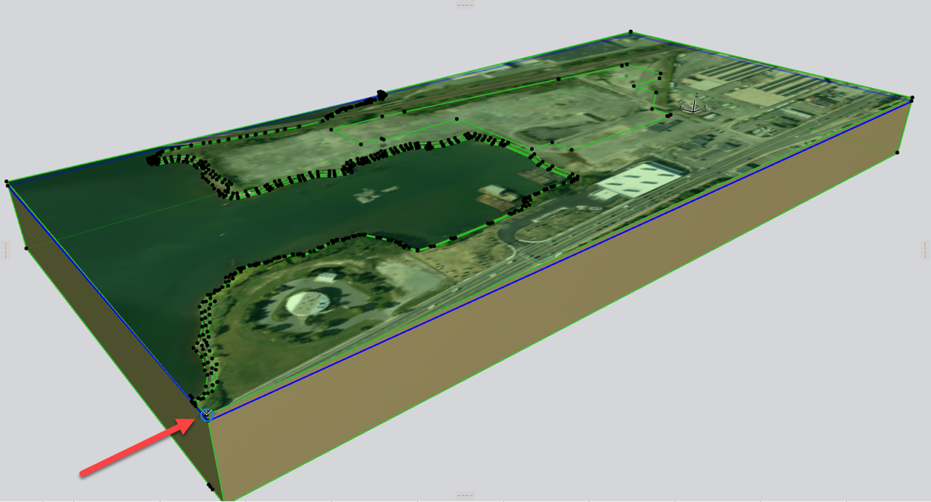

Step 7: Align the 3D Surface Texture to the Top of the Mesh
  • Select the mesh in the OpenGL 3D window.
  • Use the "Align 3D Texture" command to align the Origin of the texture to the corner of the mesh.
  • Set the Origin to the South-East corner of the top of the mesh.

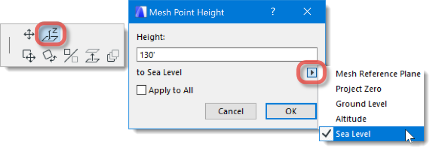

Step 9: Add 3D topography
Set Corner Elevations First
  • Set spot elevations on the four corners of the mesh, using the Pet palette.
Set Highest and Lowest Spot Elevations
  • Then set the height of the interior points using the Pet Palette.
  • For modeling terrain, you can add topo lines and spot elevations to the mesh and the top material/image will stretch to fit.
  • Be conservative at first, i.e. just add the lowest and highest points.

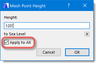

  • Set the height of these mesh contours, one by one, using the Pet Palette, but check the box to "Apply to All" so that the whole contour will get the height you specify.
