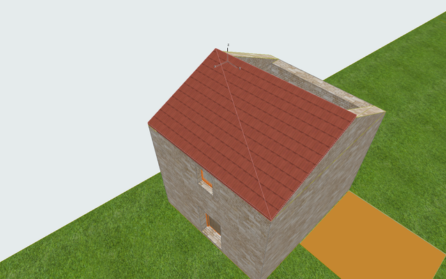

Say i have an existing old building in stone that has a kind of squared floorplan but its actually skewed (not orthogonal walls).
How would i go about making a proper roof of the existing situation?
The only solution i found was to make 2 different individual planes but i guess that wont work as a single roof entity and i might have further ahead for not having both connected and working as one?
See pictures attached please.
Cheers,
Rui

Zendrix
sorry. 2nd picture wasnt attached:

Hi Zendrix,
the Roof Tool can only triangulated planar parts. Better use the Shell Tool for this skewed roof:
AC16 - AC29, Rhino 5-8. Alienware WIN 11
Zendrix
Hi Nurbs,
Thanks for the info. Gonna investigate that.
Cheers,
Rui
