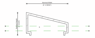

I am creating a profile with a slope.
When I change the height value, I want the tilt angle to remain the same and the shape to change as shown in the image.
I would like to change it by utilizing the height property instead of stretching.
How can I create one?
Please someone tell me.
Thanks.

With the Height modifier on, select the limit lines and use the Ctrl + D to move the boundary to only include any part that you want to stretch. You can do the same with the Width modifier.

to be a bit more explicit...you need to check the box for 'height' stretch in the profile parameters, and then reposition the top and bottom lines something like this:
That way they will only stretch the portion of the profile between the two horizontal guide lines when you change the height dimension.

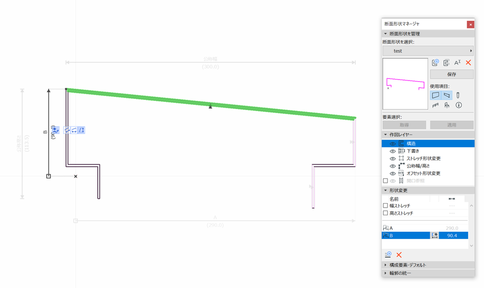

I was able to resolve the issue by changing the dimension type.
I've attached an image of the dimension type change.
The reason I didn't use the horizontal guideline of the stretch box was because I wanted to control the shape with dimension values.

I replied the Ling, but I solved it by changing the dimension type.
