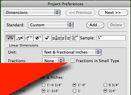

On my drawings, fractions show up as full size numbers. I suspect that there is a toggle somewhere that makes them show up as small numbers that are stacked.
Could someone please tell me how it is done?

Dwight
here
Dwight Atkinson
Thanks much. This kind of quick assistance is going to make me really like working in Archicad.
Dwight wrote:
here
