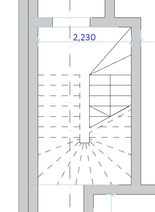

Hi! I need to build stairs like in the attached screenshot. In this case I didn't manage to get the first 2 steps, which (not knowing how else to do it) in the screenshot  are 2 different slabs shaped as if they were the first 2 steps of the stairs.
I would like to avoid usign the slab tool and to do it properly using only the stairs tool.
Can a you help me on that?

Hi! You should add 2 more heights and select the stairs, then hit the small box that will appear "modify" (or similiar in your national language), it should turn everything slightly grey, from there you can select outlines of each step and modify its shape.
Thanks for your reply Martin. The problem is that my stairs are only structure (there is no finishing) and with the solution you propose, I can only modify the width of the steps. I cannot change the depth of the tread as in the previously attached image.
