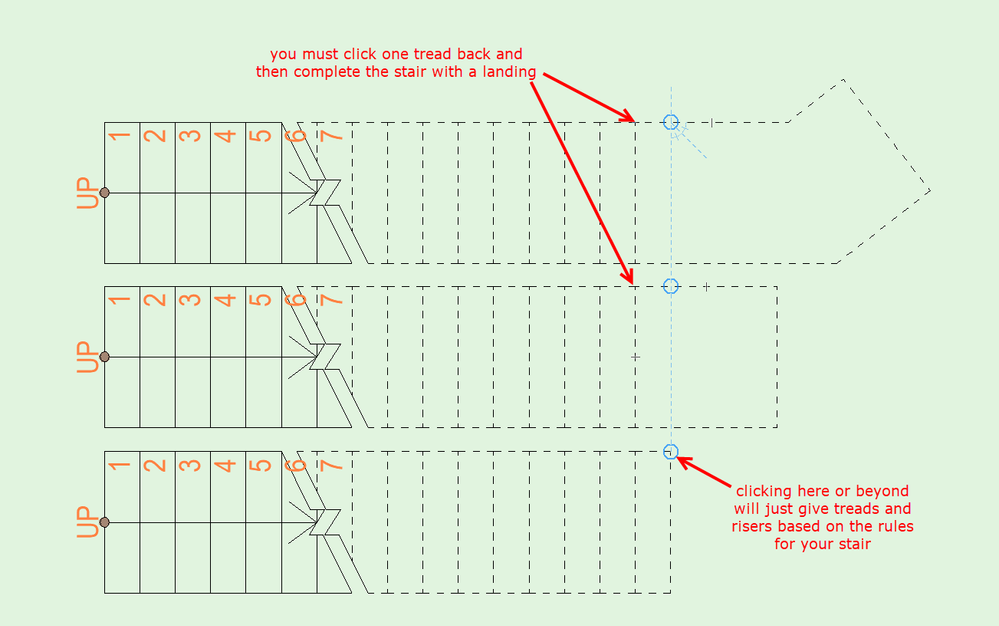

I would say that the top and bottom landings are actually your floor slabs.
The actual landings are the intermediate 'floors' between flights.
You can model the stair from the bottom up, but it is easier to go top down and start with the landing.
If you go bottom up, you must not exceed the length of your flight, otherwise you will just get treads and risers.
For your last tread, you must switch to the landing option in the pet palette, so you must click a point before the end of the flight(i.e. one tread back) and then switch to the landing, which you can make a long as you want, even bend it.

Thanks Barry, I tried that yesterday without success. I could make it work today, but it's really finicky. Also, if you then want or have to change the stairs dimensions, the last step will reappear. Once that happens it is impossible to remove it. At least I found no way of doing that.
