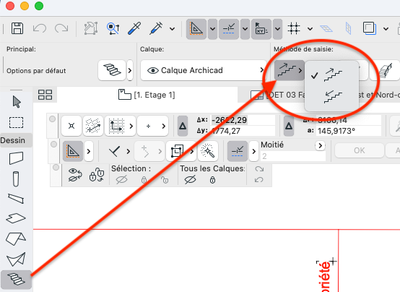

Sure, you can choose to place the stair going up or down.

You can start with a landing, but can't end with one.
So if you need a landing at the top, that's where you need to start.
