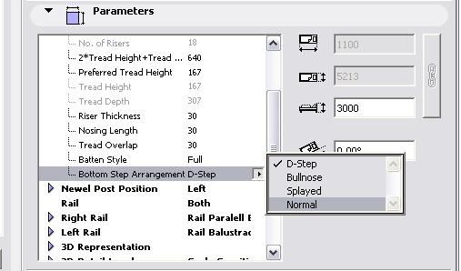

I just tried the same object, (Stair Straight Wood 10) with default settings except changed flight height to 600mm, and have a funny texture thing happening on one side only (as indicated by the red arrow). Slightly different again with flight height of 900mm. (What height is yours, Bruce?)Also seemed that I could have both newel posts, or just left side or just right side, but could not turn both off!
Bruce
You need to turn the bottom tread to 'normal' in order to be able to turn off the newell posts. Don't ask me why, but there you go.
