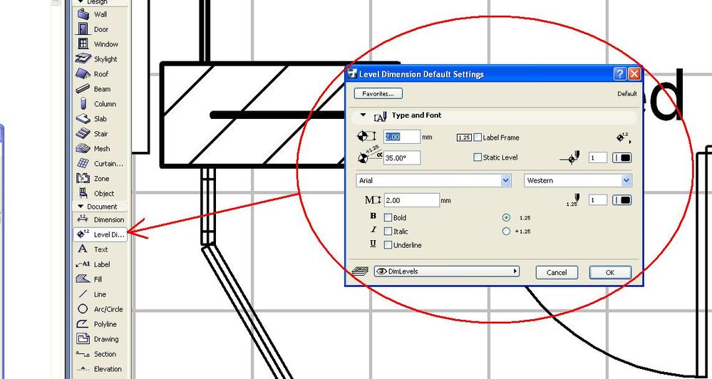

im doing it due to NEEDING the level dimention tool to work.. dosnt seem to have the option to use a refferance level only project zero

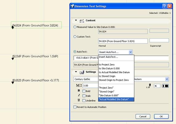

GeNOS,
The different reference levels, as well as project zero, are available under the Autotext dropdown box to choose from. You can even incorporate your own text with the autotext to convey extra info, if necessary.
To ensure consistency, you can copy and paste the finished text to other level dimensions. (Ctrl+C or Ctrl+V doesn't seem to work for me, but the right-click menu does.) You can paste into more than one at a time by selecting multiple before opening the settings dialog, which is useful!
Hope that helps!

im not talkin about the dimension tool... as per my previous posts (and attached screen shot)
mine look slike this.. i cant see any option for me to pick a refferance level
GeNOS,
You have to select the actual text not the dimension symbol. It brings up different dialog box.
One trick is to place one level dimension, select the text and open the settings, select the correct reference in the Autotext box, then OK it.
With gravity turned on, you can now multiple-drag-a-copy the single dimension wherever you want as long it is on the same piece of geometry and it will display the correct level.
To place on another piece of geometry the autotext cut and paste method described before seems to be best way to achieve it.

Well I agree with you in that case. It would be useful to be able to select the reference level before placing the dimension.
Erika just posted up a tip for changing multiple level dimension ref levels at the same time.
http://archicad-talk.graphisoft.com/viewtopic.php?p=133431
Seems to work for me!
