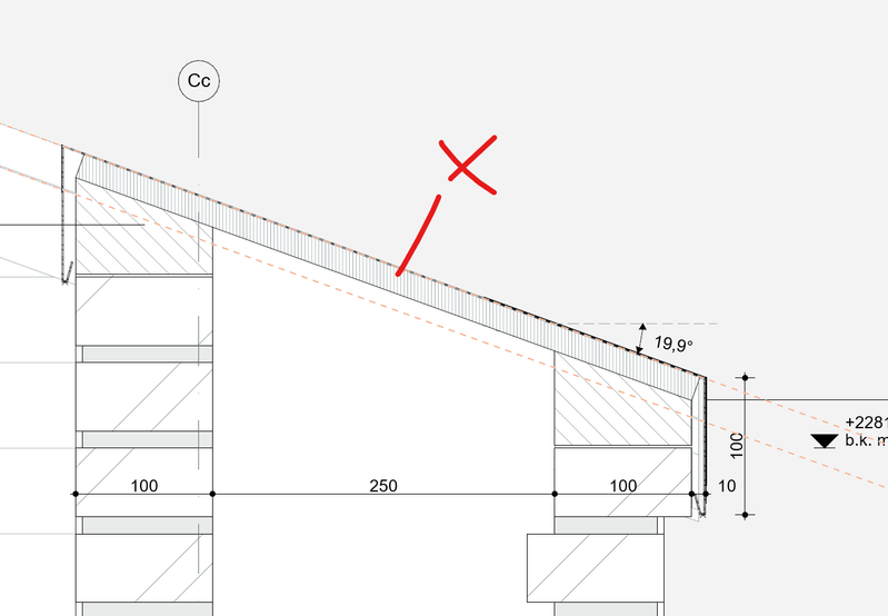

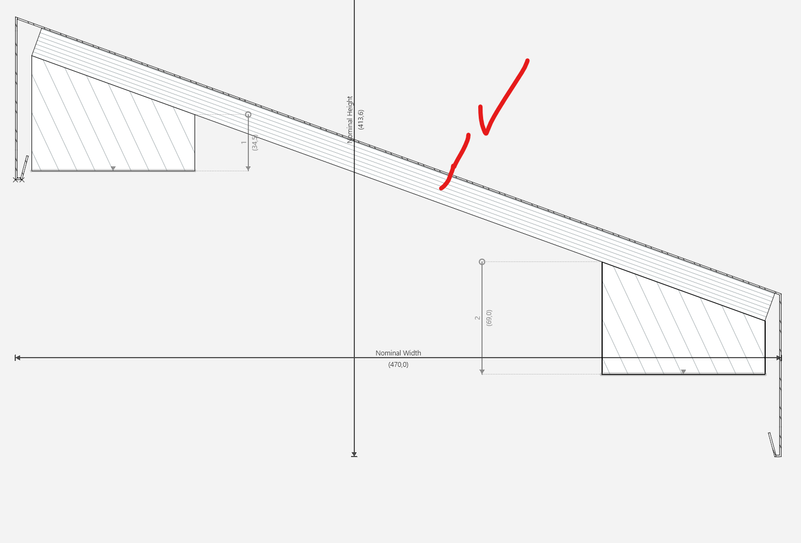

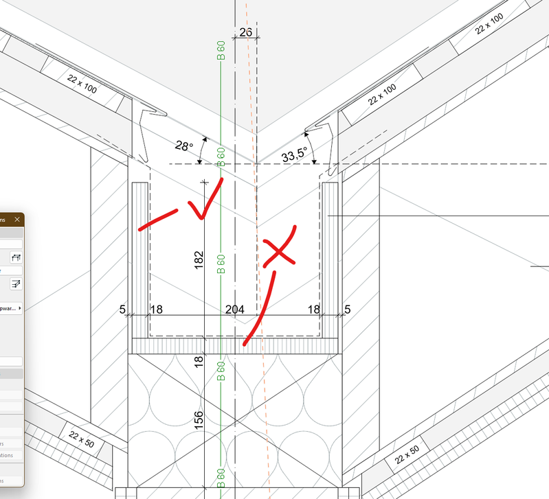

I am encountering issues with fill orientation in complex profiles.
The attached screenshots should tell the story. In general the orientation of the fills does not get displayed properly in sections, but it is good in the Complex Profile manager.

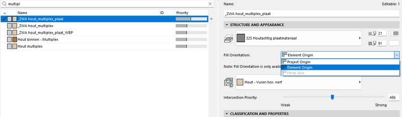

The settings in the Building Material are, of course, set to Element Origin. (fit to skin is not available)

Kindda figured it out. I had to make a symbol fill.
