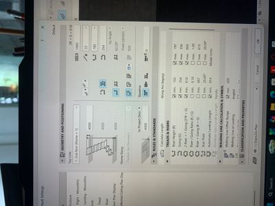

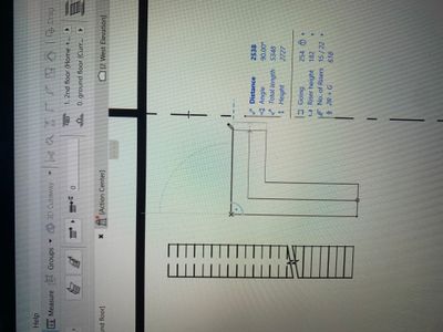

Can anyone help me why can I only draw the straight stair? When I try to turn 90 degree to make the U stair it shows like that and doesn't work. Thanks

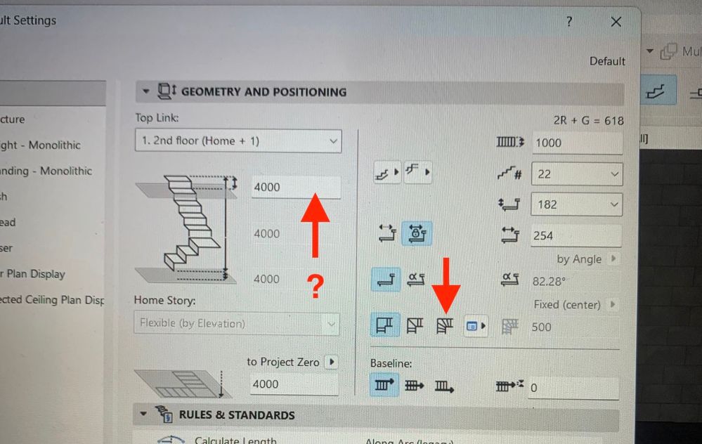

Hello anho28,
Try placing the reference line in the center of the staircase rather than outside, and also modify the value marked by a "?" and the one marked by a red arrow into my picture.
