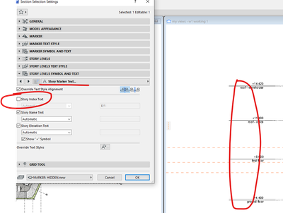

I'd like to eliminate the 'number' in front of the story setting text under story settings. I'm sending an attachment to clarify. In addition, I'd like to avoid crowding or overlap on text when a story setting is only a few inches above another story setting.

you can remove the storey number in the Elevation / Section settings:
i don't think you can offset one elevation line separately, while the others remain flat/horizontal. we never needed to in the first place.
i could be wrong. we work in 25 & the newer versions might have fixed this already.

Thank you very much. That's a big help.
