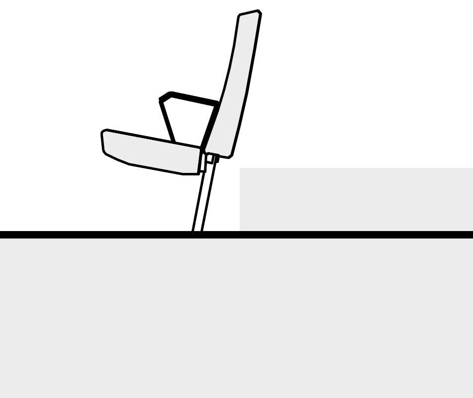

I've created several sections in my project and they all had a normal white background. After saving the .pln and re-opening it, my sections have become slightly grey in areas ( attached )
I've looked at the settings and they all seem to be fine so I'm not sure what may be causing the problem... Any ideas ?
It's on some of the slabs and one wall.

I've found that changing the section settings to ' nothing' under the Fill uncut surfaces will only changes some of the section i.e most walls are white however a few are still greyish.
It's also occuring on the Plans
What is it I need to do in order to get the fill back to white, but still retain the cut fill as black ? The settings do say white, but they are shows as grey

Nathan,
There is a Work Environment setting that appears to 'gray' fills to differentiate them from a similar screen color. It has NO effect on prints.
Options>Work Environment>User Preference Schemes>on-Screeen Options> Automatic Pen color visibility adjustments

That explains it !
