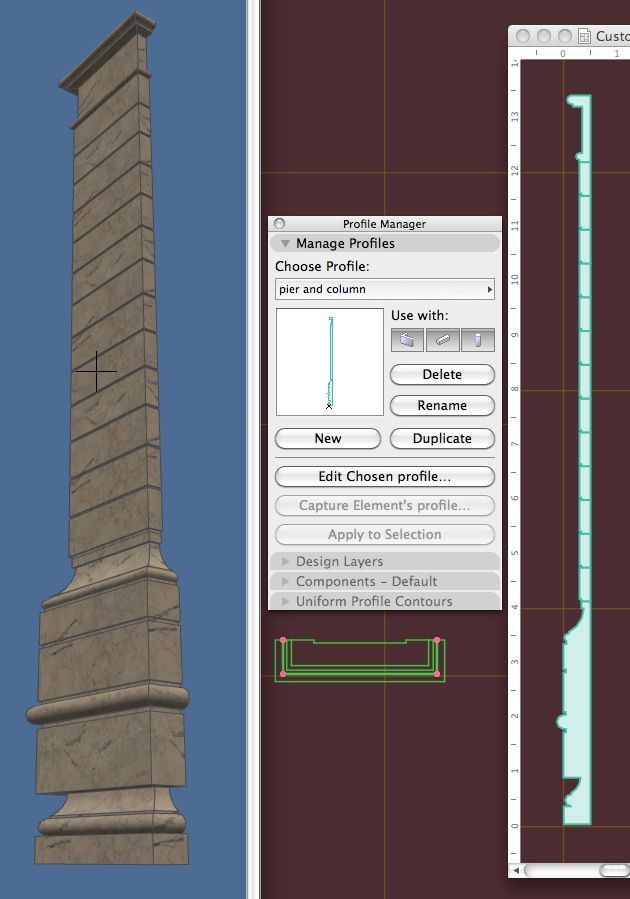

The piers and base, solved, using complex profile, again:

In answer:
I'd make a plain wall with the doors and windows. Then they show.
I'd figure out each complexity by cutting a section at each new condition, drawing each special stone/tile profile as a fill and then copying that fill [or group of related fills] into the complex profile window.
As for managing these separate profiles, it is easy to use the actual project as your reference, since you just eyedrop the value of any complex profile wall to engage those settings. But favorites would work, too. I prefer eyedrop back-referencing myself since I am a bad clerk.
