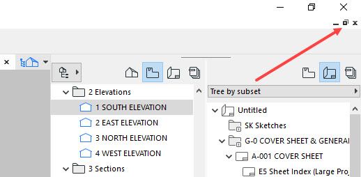

I can't find the tab to restore window. Could you provide a screen shot?

Link
Graphisoft Partner
Graphisoft Partner
We don't support people on ARCHICAD 17!
Just joking
Try this Jack...
Cheers,
Link.
Thank you Link. That did it! Tiny little button! No mention of it in " Definitive Guide to Tabs in ARCHICAD 19". Couldn't have solved it without you!

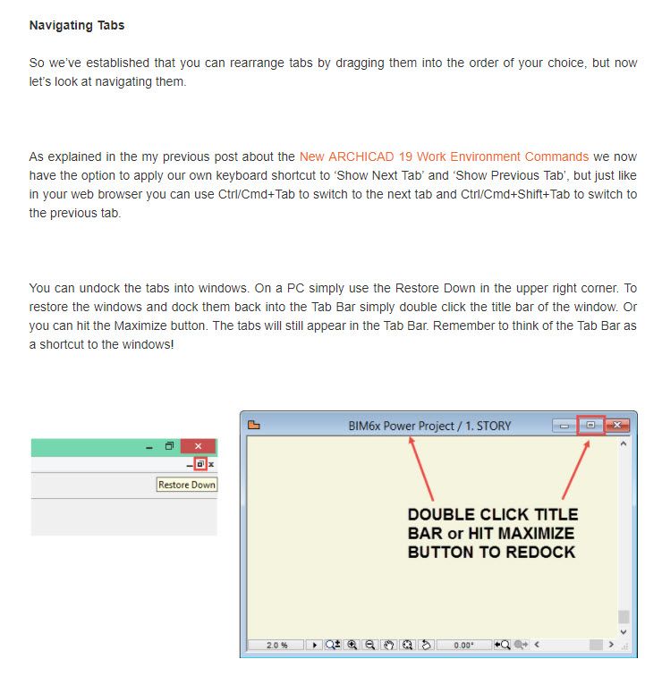

I've got the tabs working. However, I am using 2 screens and cannot drag a secondary tab from one screen to the other. What's wrong? Or is this how Windows works?
Link
Graphisoft Partner
Graphisoft Partner
It is mentioned under Navigating Tabs:

Link
Graphisoft Partner
Graphisoft Partner
On a PC you can't drag windows outside the main ARCHICAD window. So you will need to extend your ARCHICAD window across both screens.
