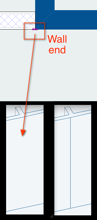

Hello all
Is there a way to get rid of the vertical line on the facade while keeping the plan intersection clean? I tried increasing priority for the facade walls but it rendered floor plan intersections incorrect.

archimax wrote:
/... Is there a way to get rid of the vertical line on the facade while keeping the plan intersection clean?/.....
No. It is a long standing wish. Having said no, you can overcome this annoying bug by using a wall end.
I will speak to our local GDL guru and ask him to post to the depository.

Erich wrote:
/...... Interesting trick. Are you just using the bog standard wall end
or is this something different and if so how?
No trick Erich. The 2D is just a small line for location. I turn if off in plan
after correctly placing.
After placing you can flip to either side that is required to hide offending line.
Part has been scripted by Ben Cohen. Waiting for his approval to upload.
The only thing yet to sort is to get the texture mapping looking right.
But with it set to a small length the slight irregularity in the texture is hardly noticed.

Thanks a lot Rod!
Regardless of a small inaccuracy in intersection that wall end workaround worked well for me this time (for 1:200 scale).
I'm looking forward for the scripted one.

archimax wrote:
/... Regardless of a small inaccuracy in intersection
that wall end workaround worked well for me this time (for 1:200 scale). /....
With our Wall End there is no inaccuracy in plan view, only slight
when a detailed material is selected for the walls shown in 3D.
I will post when the scripted part is available.
