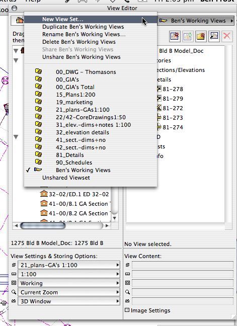

okay - a bit more detail:
see the attached screenshot image - it shows all of the viewset management controls from the drop-down box at the top of the 'View Editor'.
you can see all of the viewsets available at the bottom. the ones with the little head icons are viewsets owned by another team member that are 'shared' to the team for viewing. at the bottom is a set that i've created for my own use in navigating the project - i've shared it for others to use if they wish. it's denoted by the hand icon - this means that i own it and have shared it. the final viewset in the list is owned by me, but not shared.
other teammates can also create and use their own viewsets, and unless they've shared them they won't show up in my list.
(by the way - don't set your viewsets up like this. it's a system that we have in place for a variety of reasons, but it's not the most efficient or 'best practice': look at the defaults in a 'new and reset' document to see how GS intend them to be used! )
let's say that you have a project with various team members: "Ben Frost", "Amanda Mason" and "Djordje Grujic". each of the teammates here can sign into a project as team leader if nobody else already has this status. so "Amanda Mason" signs in as team leader and creates a viewset for all general arrangement drawings. "Amanda Mason" then shares this viewset and all other teammates now see this viewset in their view editor, but cannot edit, redefine, delete views, etc.
this viewset is owned by "Amanda Mason" not the team leader - even though "Amanda Mason" was team leader when she created the viewset. only somebody signed into the project as "Amanda Mason" can edit, add to, delete, etc anything associated with these views.
