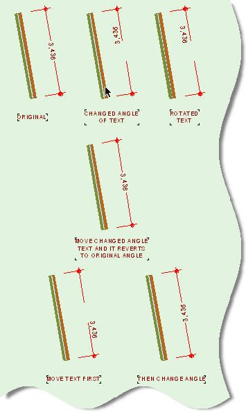

Barry,
I did not get the method you suggest to work.
I drew a wall at 100° angle, set the dimension tool to angle method,
and measured the length of the wall.
The angle of the dimension text is reported as 280°.
If I change this in the settings window to 100°, the text
angle does change and does not flip until I try to drag
the text then suddenly it flips and I'm back to where I started.
Please try doing exactly what I did and see what happens.
Maybe you know how to stop it from doing that final flip.
Thank you,
Peter Devlin
Peter wrote:
Barry,
Thank you,
Peter Devlin
Interesting.
I have never actually tried this before but as you say the text flips back as soon as you reposition it.
The only way around this is to reposition the text first (so lower-left corner is now where the upper-right corner was) and then rotate the text.
However moving the text again at any time will cause it to flip back to its original angle so you will always need to move it so the bottom-left point is where the upper-right should be and then change the angle.
Strange behaviour indeed which I can confirm in V8.1 at least.
