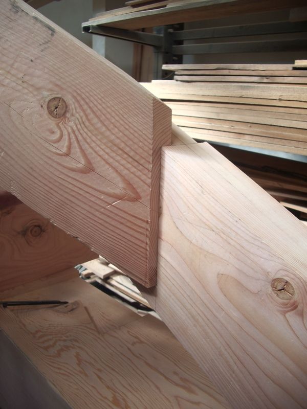

Any time you have available I would love to talk to you. I would love to send you the model if you were at all interested. My crew and I have actually figured out, by mocking up with actual timbers, the end cut of the jack rafters and the associated housings.

Here is a picture of our mock-up. The valley is alot taller than what it is here in the photo. The tops will all be at the same height.
