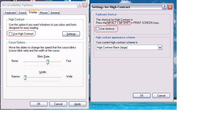

I had never done a Prt Scr with a Shift+alt keys (or even a Shift key).
When doing this Windows XP asked if I wanted to make it a "high" contrast view. (for the visually impaired and all) I said yes. I now have black backgrounds for everywhere. Scrambling through my display properties trying to fix this.
I am willing not to do this again if someone will help. I have not done a shut-down re-boot, but headed there.
Here is a Screen shot for any interested parties.

Sorry for the confusion Jay, that's why I said 'something like' as it is different for different hardware. On my laptop I need to use Fn+prtsc or Fn+Alt+Prtsc. Other desktops may just need prtsc alone or alt+prtsc for current winodw/dialog.
Looks like you'll need to adjust your Accessibility options inthe control panel. A simple Google search will provide help if you need it.

Thanks for the quick response. I will figure this out. I have always used the Prt Scr button alone and just pasted into MS-Paint (Like I did with the attachment above). It brings in both of the screens that I use and I crop there. Annotation and arrows are a bit more difficult. The AC option may prove better for the notating
It was in the Accessibility Options, Thanks.
Back to the world of Not-so-High Contrast.
It seems that it is just my left Alt + left Shift keys. I unchecked this option.
The ALt + Shift is nice for just capturing current active window, Thanks.
