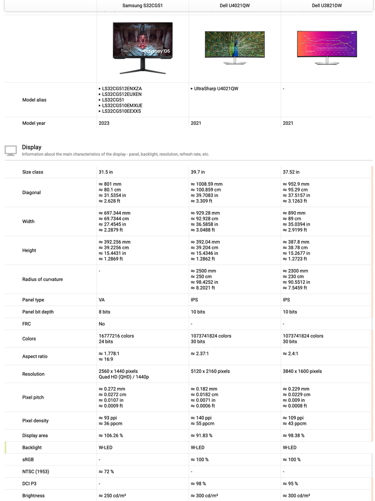

Building a new computer to run archicad 27 is there a particular type of screen I should avoid? I can't decide between a wide screen or an ultra wide screen? I'd love anything over 34inch. Ideally I would love to be able to use the 1 large screen with a few windows open one always being archicad and then email or a web browser open.
is there a preferred resolution for archicad
Any suggestions would be greatly appreciated

I would recommend a monitor with an IPS panel if it is primarily for work such as any of the Dell Ultrasharps.
mikas
Display size and pixel sizes are very much of and about personal preference. That Samsung seems to have unnecessarily big pixels, at least to me they would be. I think 109 ppi is the normal for 27" 2560x1440 monitors.
As mentioned by Barry, the super dense pixel monitors can have too small text and buttons at default resolutions. That too depends on your preferences and you eyes of course.
On Mac, they use (Apple uses) Retina pixel densities. It's 4x the normal density. Text and interface elements are still that of a 109 ppi monitor, but the huge resolution adds up to a super crisp view for the user. You have almost true hairlines for example.
I jumped from Mac to PC a few years ago, but still have this 5K iMac 27". It beats all my Dells and Samsung with its crispiness.
That said, you can have the "Retina" effect with a PC too. My main display is now Dell U4021DW (40": 5120x2160), with a pixel density of 140 ppi. I can change the display scaling aka resolution, or interface elements to 120 125% for example, but the Archicad lines (or anything displayed) will be crisper to my eye. It's not that Apple "retina", but in that direction of display crispness.
I have tried many displays till today. I like the Dell U3821DW (38" 3840x1600) too, it's 109 ppi, so a normal-density monitor.
Samsung 49" 5120x1440 is 109 ppi, and pretty handy because it can double as two monitors if you need to. It can split two display streams side by side. So can the big Dells too as a matter of fact. It can be convenient in some use cases. Windows 11 does have pretty good window management today, I am quite pleased with their solution at that. Please see some monitor specs compared in the screenshot (https://www.displayspecifications.com/en/comparison/6a452fb6cc#google_vignette), maybe pay attention to ppi when choosing the monitor for your work, and consider closely your eye capabilities too. BTW, you can have 4x 2560x1080 Archicad windows tiled simultaneously with that 40" Dell, attached a pic from my desktop today. I had a heavy multitask-day today 😉

Ideally you will not use Scaling for what ever monitor you get, as you will lose sharpness as you try to display half pixels or get to a point where you should have just gotten a monitor with a quarter of the resolution...
Retina computer screens are >200 ppi but everything is designed to an appropiate scale for it. This sort of ppi works poorly on Windows... I had a laptop once with a ppi of 260, that for many people would still be too small at 200% scaling...
