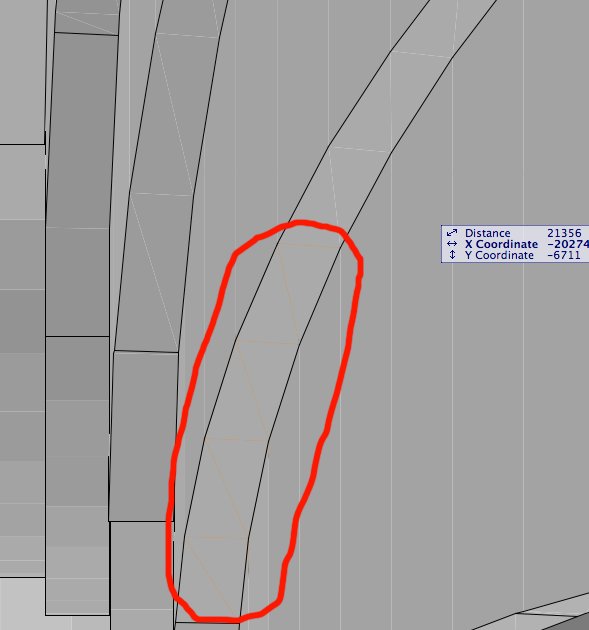

I have generated this section ( attached ) from a 3D model ( which I though was the correct procedure or creating sections ). I've taken it to my Tutor and she's moaning because it's not ' clean ' enough i.e there are a few lines that end up ' no where ' How can I trace this so that it follows the same shape but allows me to keep all edged joined... I could change the section but the problem would still be there.

I've just had a go with the fill method and as you can imagine, this will take a long time. Where can I change the cut in OBJECTiVE so that it's solid ( if possible ) and how can I remove the ' pinstripe' effects across the whole model ? I've changed various settings but then I end up with a completely blacked out section.
Attached is a screenshot of the fill I've added ( circled ), and the rest of the drawing shows the stripes that I wish to be like the fill.
Use the Floor Plan and Section settings to control the fills of objects cut in section.
The pin-stripe is the edges of the fills created from the faces of the 3D model - this is a weakness of ArchiCAD's shaded elevations. I recommend rendering the model and overlaying a 3D hidden-line view of the model (using the Internal Engine set to Hidden Line). You then get very smooth surface shading coupled with crisp edges.

I've had a go at using the hidden line method and I've posted he results. As you can see, it has ' lost ' some of the details in 3D mode, especially the rivet, also in section view, the still don't quite join as I would like them.
Should I just try the sections with the fill method, or is there anything that the 3D window settings can do ? ( I've had a look but since I'm not experience I'm not sure which setting will work best with other. )
