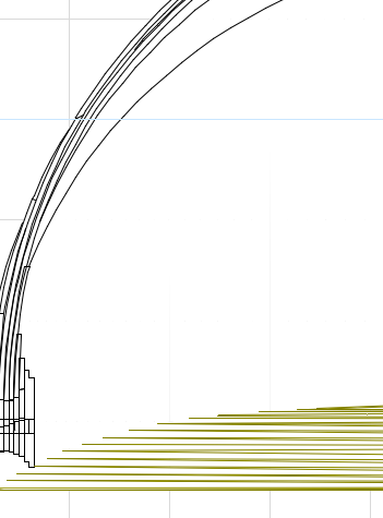

I have generated this section ( attached ) from a 3D model ( which I though was the correct procedure or creating sections ). I've taken it to my Tutor and she's moaning because it's not ' clean ' enough i.e there are a few lines that end up ' no where ' How can I trace this so that it follows the same shape but allows me to keep all edged joined... I could change the section but the problem would still be there.

Try a SEO (Solid Element Operation) and subtract the object from the mesh. You can find all the information to do this operation in the ArchiCAD Reference Manual.

NStocks wrote:You can draw additional line-work into sections if you wish. I usually do this in elevations, adding thicker lines where I want to add some relief or depth to the drawing.
You can also mask over unwanted lines with fills. Alternatively (if you believe you aren't going to have to repeat the exercise) you can unlink the section from the model so that it becomes nothing but 2D elements. You can then freely edit or delete elements as required.
