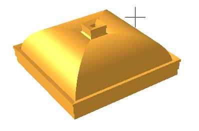

You've probably got your magic wand resolution too low.
But forget the roof tool entirely for fancy roofs.
Ever since they brought out the custom profile for the wall tool, that is the, as Borat would say, poosiecats eh-noose, for arcs and fine details included.
Draw anything, illogical or not and the wall tool will draw it. The barrel vault roof tool is picky as to the logic it will tolerate.

Thank You Dwight and Peter for your help -
sure enough my magic wand settings needed to be adjusted. Take care and thanks again.
