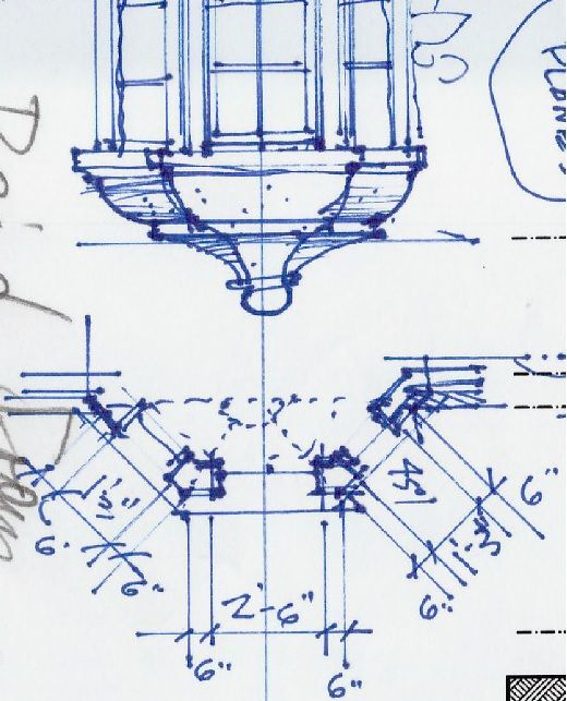

Trouble with modeling this
Srinivas
Can someone kindly help me in figuring out a way to model the base of this bay window. somehow I am having difficulty modeling this with ArchiCAD 16.
Thank you in advance.
-Srinivas.

Hmooslechner
There are more ways to solve this topic.
First: -construct a new profile - (Options-Profile-manager) for a wall.
second: - its possible to do this with shells
third: - Morph can do that too.
fouth: - You can make this with self.made GDLs.
Most sens: Profile or Morph-tool-solution
Srinivas
Did tried with profile,but doesn't seems to work, I am out of office, I would have posted image from what we got from profile. Not very good with Morph, that's where I think I am having trouble modeling it.
Thanks for your time.
-Srinivas.

Hmooslechner
This is a possible way for the profile-manager wall...
You have to construct the profile exacter than me, i did that freehand - so its not very accurate. But i think You get the idea..
its in upload now for about half an hour..
youtu.be/v27GgqkmfBA
The benefit of this way: it is a wall and You can put Archicad-library-Windows into it...
