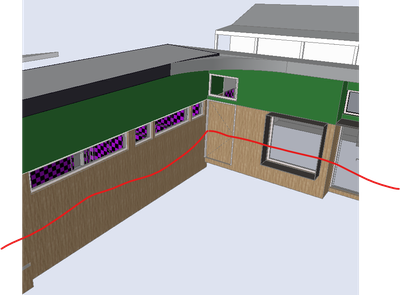

5 hours ago
The red line indicates the cut plane. The square window on the right is showing but the high narrow windows to the left aren't showing on the RCP. They are on the same wall and same story.
3 hours ago
Given the green sections, are those two walls stacked on each other? If they are, they are on the same storey, and the upper wall is set to Symbolic Cut, then check the Display Order of your walls. Turning on Trace with Transparent Fills will generally show you if this is the issue.

3 hours ago
Changing the display order doesn't fix the issue, the walls are on different stories so maybe its because the windows aren't being cut that they aren't showing?
3 hours ago - last edited 3 hours ago
If the wall the window is in is getting cut, and the window is set to Symbolic, they should show regardless if the window itself is actually getting cut. Try setting your wall to Symbolic Cut.
