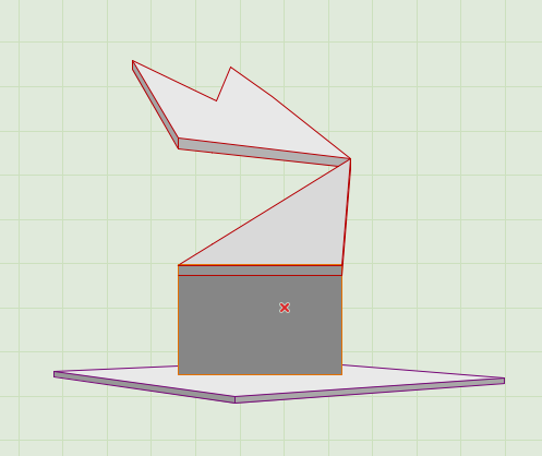

Eduardo Rolon
Works with slanted
Eduardo Rolón AIA NCARB
AC28 US/INT -> AC08
another Moderator

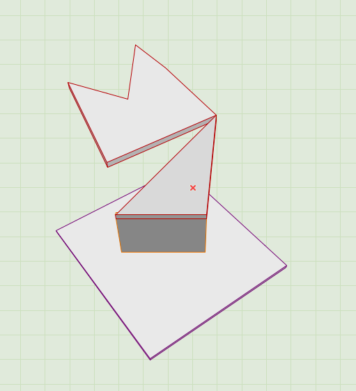

Eduardo Rolon
Perpendicular to Wall
AC28 US/INT -> AC08
another Moderator

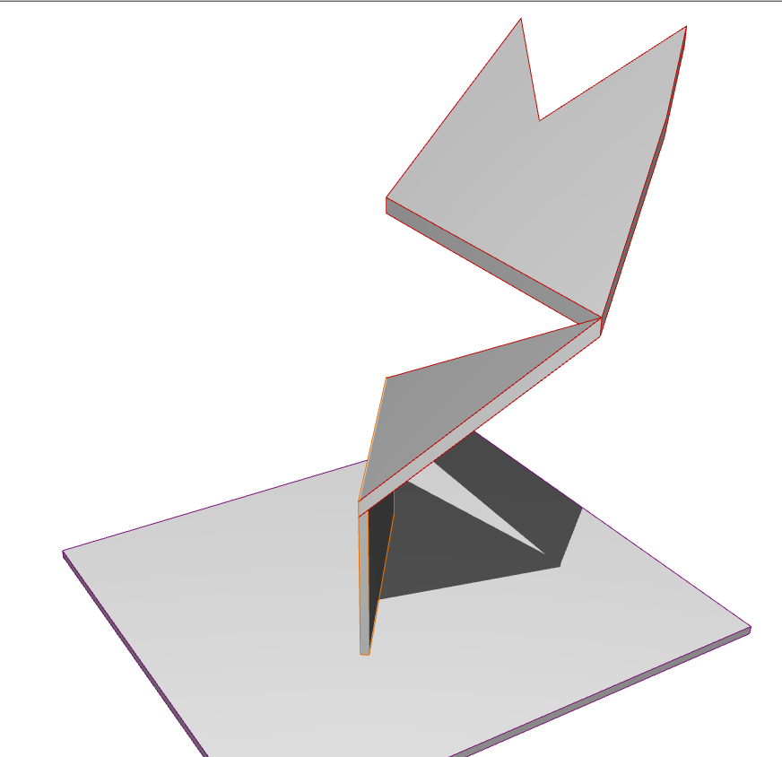

Eduardo Rolon
Perpendicular to first roof
AC28 US/INT -> AC08
another Moderator
Eduardo Rolon
Perpendicular to second roof
AC28 US/INT -> AC08
another Moderator
