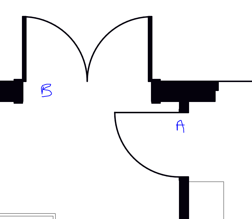

How would I update the settings of door A to match the settings of door B (I want door A to show thickness in the door panel).
I am using both as Door 21 from the Archicad 21 library.

That would be down the the 2D Detail Level of the doors. Generally you wand to keep that "By MVO" so that you can globally change their representation based on the requirements of the View. My guess would be that one or both of your doors are not set to this in which case they will need to be manually changed to match.
Ling.
Patrick M
1. Eye drop door B
2. Inject into door A
3. Select Door A and open settings (com+T/cntrl+T)
4. Locate the previous door A library part and inject into that door type/library part (com+opt+click)
5. Adjust Door A width/height to previous dimensions
