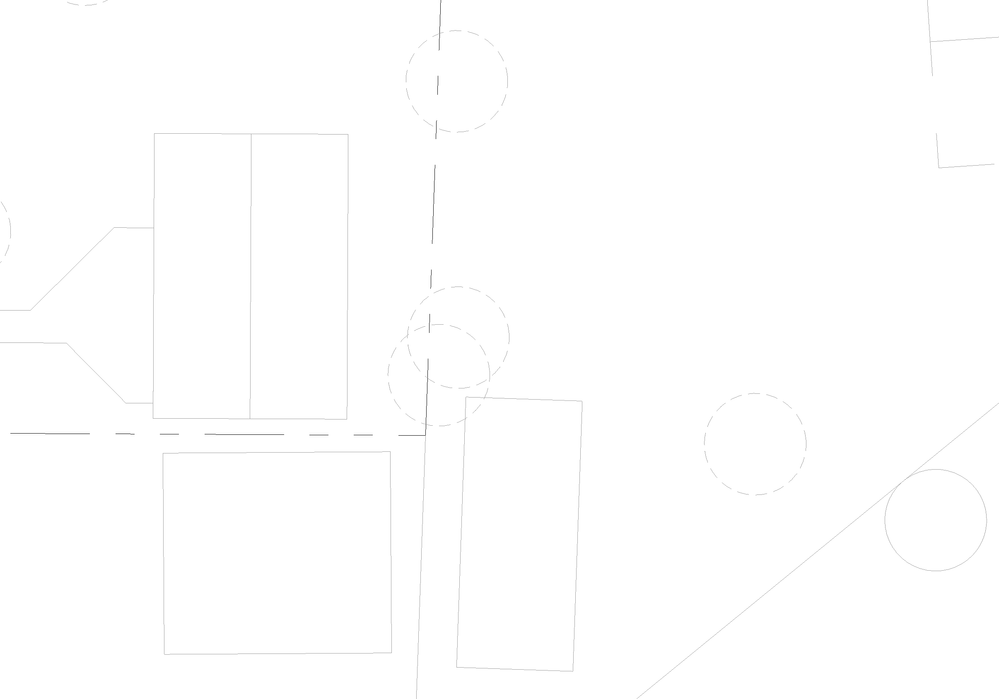

Hello,

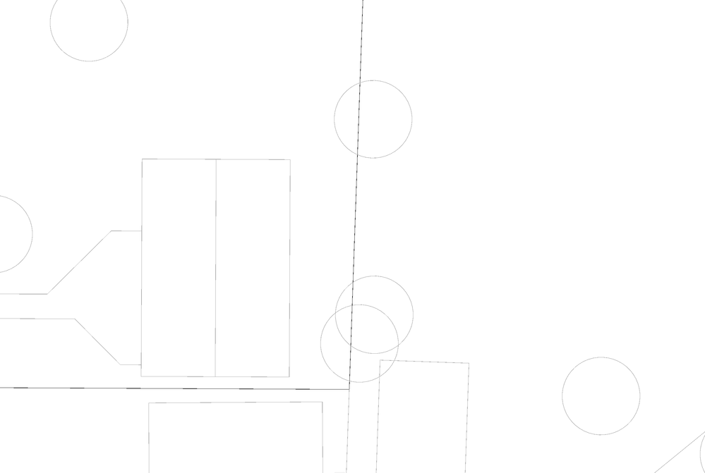

I upgraded my Archicad to the 26 Version and everything works just fine with the exception of the shown elements and lines getting displayed in a weird, pixely way (take a look at the pictures). Zooming in and out doesn't look how it supposed to do. It looks like there are 2 Lines in the same position. Is this a Archicad setting thing or has this something to do with my PC? But Archicad 25 works just the it should so I guess it is an Archicad setting problem right?

Archicad 25 uses open GL while Archicad 26 uses directX. Make sure your graphic card and the driver is capable.

You haven't got a duplicate showing as a trace reference have you? Make sure your Trace and Reference is turned off.

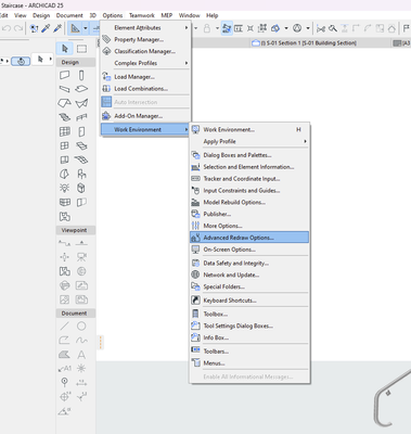

do you have 2d antialising turned on?
options > work environment > advanced redraw.
