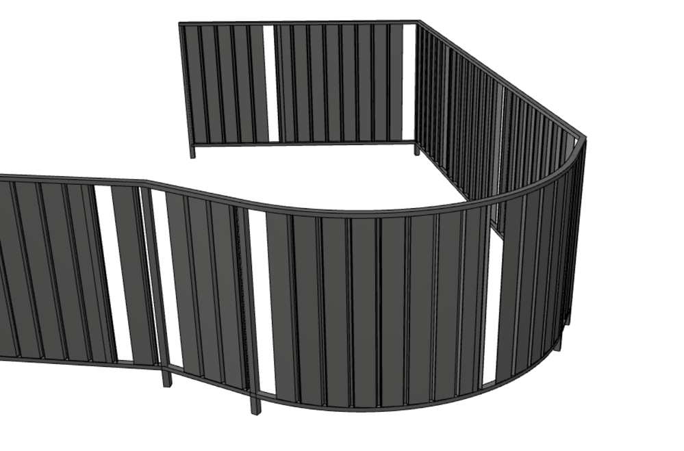

I have been playing with the new railing tool and can definitely see the potential.
I am attempting to create a metal profile fence which is pretty typical in the Australian market.
I am using a complex profile baluster in between posts and railings. One thing I cannot get right is for the balusters to run all the way to the posts. I can see the logic why it is not working, but hoping someone might have a solution or a work around. I'd like the pattern to continue ignoring the posts or extrude continuously until it hits the post (like a symbolic line would) rather than leave a gap either side.

In the Railing Settings Dialog, activate the "Node" page in the left pane.
Then on the right, switch the "Pattern Continuity" field to the "Continue Pattern" option. I hope that will achieve what you want to do (although I suspect it might still not do what you want exactly at corners).

Hold the phone....
I've found what works for me.
You need to tell the balustrades to go beyond the post, by entering a negative number in the "Baluster Pattern Right Offset"
You'll see in the attached image my spacing for each (pair of) palings is 200mm.
So... I needed to put negative 200 in the baluster offset field to compensate.
(See attached)

Laz - see attached.
On the complex profile technique - it turns out my minus-200 trick only fixed the intermediate posts, not the posts at nodes.

You can select any Post and select the "Invisible" GDL Object option for it, then it will not be visible.
In Edit Mode you can experiment with the "Convert Pattern to Segment Length" context-menu command. Select any sub-element and use the command. Then every sub-element can be individually edited (the left/right offset of each Panel can now be individually set) and you may be able to modify the panel offset at that Post.

Thanks for the feedback dv_chris and laszlo.
I already tried dv_chris suggestion to offset balusters with negative value, however it never quite gets it right.
Laszlo's pattern continuity does change the way the balusters behave but does not fix my problem.
I was able to come up with a solution / work around for my fence but not without some "fudging".
Rather than placing balusters only, I opted to do a solid panel with metal profile balusters in between. This eliminates any possible gaps. It did mean that my 3D representation will not be 100% correct from both sides but close enough for my needs.
Unfortunately AC21 does not allow to place balusters in same area as the panel. This is where using negative offsets allowed me to work around the problem.
